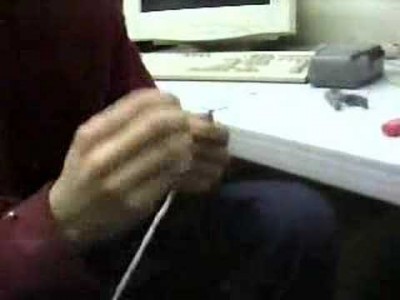

Hi, ~ my cable company offers me Internet connection via a cable modem (road runner is the company I think) ~ I need to make a Straight-through CAT5E cable so I connect my wireless router to the modem ~ The thing is that the cable I got, even though it says "CAT5E" on the cover it is not showing me the same colors that are used to match the pins to the RJ45 connectors, as I see them in, e.g.: ~
I don't see any blue cable I am not Daltonic ~ I had done that before and I even got a cable near by to confirm the coloring, however the extra cables I got don't have the right coloring ~ Any ideas how to use them? ~ Thanks lbrtchx

One pair should have a blue or blue-white(trace) wire twisted with a white or white-blue(trace) wire
What colors do you have? If you have red, black or yellow you probably do not have Cat5e.

Well, even if the cable itself clearly says CAT 5E on the cover I dont see plain blue or white with blue stripes cables. Here it is how it looks like:

The main issues are: T-568A or -B pattern, solid flex, IDC compatibility, and seating depth. there may be others.
The photo isn't great, but it looks to me like your pairs are (L-R) orange, green, blue, brown. Don't argue shades until you can explain why Slate matters.

Yeah, I dislike that kind of coloring. The 2nd pair from the left looks sort of blueish to me. I think you have them sorted properly into orange pair, blue pair, green pair, brown pair from the lowish quality pic this is. Every company is different. Some are nice clear color coded with stripes, others like this have muddy colors that are hard to tell apart and you have to make sure not to lose the associated white out of each pair once you untwist to shove in the plug because you won't be able to find it again.

have no idea what kind of cable you have there... ??? is each pair twisted together by itself ? try a normal technical resource - random selection from Google
I seriously doubt it is stamped with a CAT5 or any data markings ? It's just an 8-conductor cable.... and that is NOT going to work.
If you had looked around the Internet, (besides your contnuous YouTube postings) you would have realized it did not look anything like a CAT5 datacom cable.
I've handled Cat5e cable like his picture shows. It was legit cat5e cable, not everybody makes it the same. Some is crappier than others, anything to save a buck or two here and there during manufacturing.
