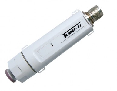

Those Alfa Tube-U units seem like the way to go for 2.4 sniffing if you are going to use a big ass antenna. The desktop models work fine but aren't very rugged. It is well worth the extra $10 to get the beefier model.
Excellent receive capability. For long distance use, you might was well get the G version. Even though it only specs out 1dB better, in practice it really works well and you won't be getting N speed anyway over distance.

I have a Bullet M2 which looks exactly like those Alpha Tube-U units. I wonder if the Bullet M2 can be put in promiscuous mode?
The antenna is no problem. They're cheap and the bullet screws directly onto the connector in back.
