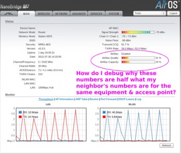

(A plus of the Ubuiquiti AirOS operating system on the radios is that they all come with a spectrum analyzer, which is really neat and powerful. Here is a GIF picture of an analysis I ran years ago.)
HINT: My AirView pictures are all over the net, which is interesting as I come up in the front page in almost all DuckDuckGo searches (on almost any topic) whenever I search for stuff I've worked on - so lots and lots of people must be benefiting from my thousands of posted detailed pictures over the years.

Looking up the specs on my nanobridge M2 "NBE-M2-400 US"
The Antenna gain is 13dBi to 18dBi (note that my Rocket M5 antenna is
30dBi) where every 3 dBi is a doubling of power (and a narrowing of the beam).
