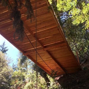

Here's my rendition, showing both where we are, and where we're going:
I am omitting the actual building structure, which looks like this:
So, below, are drawings, but not the actual pictures of us looking like fools high up in the redwood trees of the Santa Cruz mountains:
  1. The starting point, on a steep slope, with a path near the top:
  2. All brown lines are 16-foot long lengths of lumber:
  3. This approximates the "ladder network" you've seen in the photos:
  4. This was the first (thin) cable that went from tree to tree:
  5. From that thin cable, we hung two large safety cargo nets:
  6. Then we hung the thick cable, which was initially 250 feet long:
  7. We sunk two fenceposts, so that the platform rested on the ground:
  8. Then we built & suspended the first 16-foot by 10-foot section:
  9. Yesterday, we hung the second 16-foot-long section which is a foot or two shy of the smaller redwood pair of trees:
  10. The plan is to add successive 16-foot sections, one by one:
  11. We keep that up until we finally reach the big redwood tree:
  12. And, finally, we'll add 8'x4' sheets of plywood as a railing:
    After that, we begin to build the actual treehouse, complete with WiFi, refrigerator, bar, running water, and heating (no kidding).
It will take time, of course, so, I'm not sure if I should continue to update this thread, but, since we've never done this before, any and all advice is welcome.
PS: Jeff Liebermann and SMS are both welcome to attend the Internet WiFI setup party since they both live in the area!
Sure. Do I bring a parachute or my climbing gear?
Ummm.. wi-fi setup party? Is that like work as in a paying service call?
I dunno. The dog is smart enough not to set its paws on the deck. The people, maybe not so smart.
In about 1985, I installed a 20 meter dipole between two redwood trees on about a 45 degree sloping hillside. On installation, the dipole was quite horizontal. About 20 years later, the downhill side was about 3 ft higher than the uphill side. What happened was that trees grow vertically near the top, and outward near the bottom. The antenna tilt was caused by the difference in vertical growth rates. I sure hope the end supports of the deck are adjustable.
