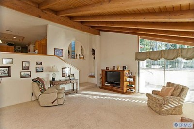

... Here are two previous owners' photographs/photos. of the downstair family/living/den room, with its bar, with the weak wireless: (facing the direction where wireless router is; note the kitchen on top left)
Wireless suggestions for a big house? open original image

I need some suggestions/consultations on settuping wireless for a big one floor (but on a giant slope hill as if it had two floors) house. About 88 feet seems to be the longest distance from a small room with the new cable modem. This is based on Google Maps' aerial shot with its ruler:
side/east is a huge hill with trees; green pin is where the cable modem is).
Building Information: Ground Level Entry (No Steps) Stucco Exterior Concrete Tile Roof Cathedral-Vaulted Ceilings Full copper plumbing
3,900 feet Built in 1986
16 rooms (4 bedrooms and bathrooms) Split-level and contemporary style
Just for kicks, I tried an old 15" MacBook Pro and a Linksys WR54GL wireless router (both were from late 2008) in it. Here are the wireless results:
Kitchen's tables next to windows = 2-5 bars
Downstair/Lower Elevation Family/Living Room: Couches and table = 1-2 bars ; laggy when ssh to an outside server; a few packet losses to router. Behind the bar counter = 0 to 2 bars
Room Near Kitchen and Garage = 3-4 bars
Garage = 4 bars
All other rooms look good/high.
So it looks like they will need a network cable/repeater/something to the downstair area if using an old Linksys WRT54GL router. However, the folks did not want network cables in the walls, attic, etc. so it would have to be wireless, coax cables (over the air (OTA) and cable services are already using them though), or power cables (already crowded on the outlets with strips).
Are there any strong/better wireless routers that can reach farther and be stable/stronger? If not, then which wireless routers can do it? It would be nice to have third party firmware options like Linksys WRT54GL routers. Also, fast speed like gigabits for fast local file transfers between computers in the big house if possible. 100mb/sec is slow these days!
Thank you in advance. :)
3900 sq ft and 15 rooms? That's 244 sq ft per room average which is not much bigger an a king size bed plus walk space. The place must have lots of tiny rooms or is setup as a dormitory. Note that closets, utility rooms, and enclosed stairwells, are not considered rooms.
Looks like there's a crawl space about the kitchen for duct work. Put an access point up there. With a split level design, you should also have some utility space in the upstairs floor and/or downstairs ceiling. Put an access point in there unless you have aluminum foil back insulation crammed into the space.
Not too horrible. Two bars on the MacBook Pro is too low to be usable.
Yeah, I notice that there was only one outlet per wall, nothing near the fireplace, and no power in the open beam ceiling. The signal levels look like there's nothing conductive or absorptive in the walls. Looks like a cheap spec job.
How is the communications utility wiring? Anything available for a HomePNA or HomePlug backhaul to an additional access point?
Yep. The MIMO based routers are better for dealing with reflections and usually have a little more range at the same speed as a conventional router. However, I don't think it's worth the effort. If you put the main router in a corner of the house, and spend some time playing with various directional antennas, you can dramatically improve the signal in the desired direction (at the expense of coverage behind, above, and below the pattern). Sector antennas with lots of gain in the horizontal plane, and very little in the vertical are ideal.
It won't do anything for downstairs, but I think you'll need a 2nd AP downstairs anyway.
Do what? Cover the area? That's mostly a function of the antenna, not the router. Even a piece of junk with a decent antenna will be better than the WRT54GL.
