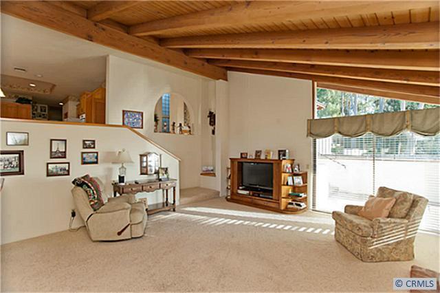

I need some suggestions/consultations on settuping wireless for a big one floor (but on a giant slope hill as if it had two floors) house. About 88 feet seems to be the longest distance from a small room with the new cable modem. This is based on Google Maps' aerial shot with its ruler:
side/east is a huge hill with trees; green pin is where the cable modem is).

Downstair/Lower Elevation Family/Living Room: Couches and table = 1-2 bars ; laggy when ssh to an outside server; a few packet losses to router. Behind the bar counter = 0 to 2 bars
