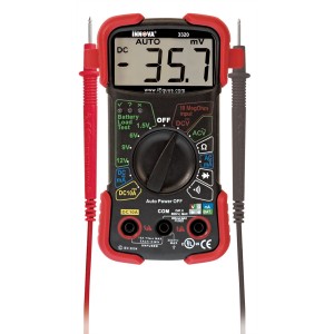

  1. Do you have a DVM (digital volt meter)? Put it on an AC voltage scale and check if there's any AC power line voltage across any of the USB cable connections. There should be none. Also, unplug the USB extension cable and measure between the cable shield and the case of the computer and/or USB hub.

You would think so, but it's been on my bucket list for, oh, 30 years. And Harbor Freight discontinued all their seemingly perpetual "Free VM with ANY PURCHASE" (only half of them worked more than 3 times - according to the reviews). I did get a few decent LED flashlights, though.
I have a whole dead circuit in the house and I can't even find the breaker that controls it - everything in the breaker box turns off something. My "voltage meter/tester" is literally an electric hand blender (Braun). I'm not a rich as I used to be <ahem>.

I've been happy with the Innova 3320 Wal-Mart had in-store years ago for ~$20. It wasn't on the rack with the other DVMs in the store -- it was over in the Automotive section, I figure because the packaging said "Auto-Ranging". :-/
Advance Auto Parts appears to sell a non-auto-ranging Innova DVM for $19.99.
If you do get one of these, beware that they, like many other VMs, have a fuse to protect them against high currents, and it's not that hard to blow out the fuse accidentally. You'll probably want to buy extra fuses. The easiest way to tell that the fuse has blown is that the battery test lights no longer work. -WBE
