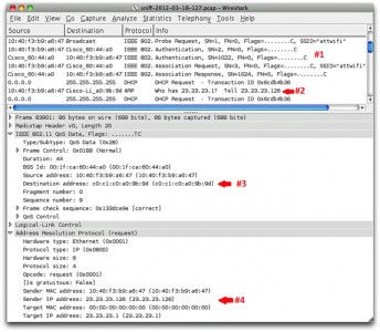

I always advise anyone with an iphone just to throw the s*it in the trash and use anything else. But it you use the iphone, here is yet another security breech:
It is too long to cut and paste, but basically the iphone spews out the last three MAC addresses it used in the ARP. Why, I don't know. However, using the google mac to location database, you can be tracked. Is this really a problem. Well it depends on if you are important enough to track.
