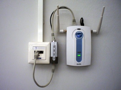

if you want to connect the two sites using wireless, you must use point to point backhual bridge or wireless AP with bridging support.
i do recommend using 'ZyXEL G-6000 series '
outdoorpoint to point backhual Bridge, it's a heavy duty one and will do the job.
