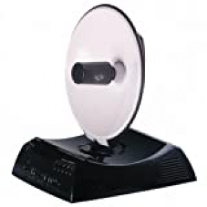

Hawking HWU8DD Dish any good for extending WIFI range ? open original image
I am interested in a way to extend my laptop range so that I can connect to WIFI networks that are farther away. Perhaps when I am at my mother's house and I might want to hook into some neighbors WIFI or when I am camping. I stay at a campground in Maine and I have to be close to the main building to get the WIFI, but if I had better range I could stay at one the nicer sites in the back. This hawking unit seems to have some good reviews though I guess it's a bit delicate, any recommendations on this or similar units ?

Well, let's make some assumption and play with the numbers. The range of a typical USB device, with a built in 0dBi or worse antenna, is somewhat worse than what you would get with a typical MiniPCI laptop using diversity antennas at the top of the LCD frame. The only real benifit to USB is that you can relocate it and its antenna to a more favorable location.
For the sake of guesswork, let's assume that the tx power outpuit of the USB adapter is about the same as the MiniPCI card in your unspecified laptop. If I assume a 0dBi antenna gain for the laptop, and 8dBi for the dish thing, then the range improvement will be: 10^(8dBi / 20) = 2.5 times That's probably worth the effort.
Incidentally, I ran the numbers on the Hawking dish and a flat panel equivalent and found that it really does have almost 8dBi gain:
However, I wouldn't do it that way. Methinks you will probably need a bigger gain antenna, with perhaps 12 to 14dBi gain. That will yield 4 to 5 times improvement in speed. You can do it with your existing MiniPCI card by adding an external antenna, or using a PCMCIA card, or USB device with an external antenna connector.

Even tech support at Hawking couldn't solve my problem. Device Manager shows the hardware to be working. It shows a 47% signal but refuses to connect. I can connect to the same signal with my Microsoft MN-510 from the same location. Any solutions? Otherwise it will continue to collect dust in the closet. LZ
This is one symptom of a date/time mis-match.
Check that the clock is close on the equipment on both ends.

Actually there are 3 wifi signals showing up, ALL are open access. The one I'm authorized to use is a QWEST DSL belonging to the resort. There is also a LINKSYS and BELKIN, all 3 work with my MN-510 with no problem or special configuration. Plug it in and it works.
