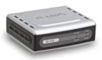

Tried the Hawking band of the attached link with no luck. Not sure if this DLINK model would help or not-I assume not.
