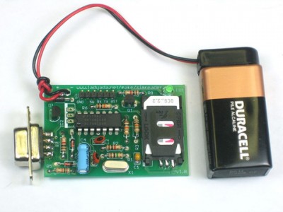

I'm still looking for a SIM card reader that won't destroy the SIM. With that, it should be easier to backup/restore SIM data than the poor software from Motorola (similar to how I remove a CF card from any of my DSLRs and place it in a card reader to transfer pictures rather than connect the DLSR directly over USB) -- using the CF in a reader is akin to using it simply as a removable disk (vs. the complex and kludgy USB camera interface)).
User reports of many/most SIM card readers are horrible from what I've seen so far, and those whose specs seem good are located in the far east (per a whois) and don't sell over the web as far as I can tell from their webpages.
Does anyone here have a recommendation for a SIM card reader?

OUTSTANDING! That one looks great, kit and parts are USA-made, and the software is for Linux, Mac and Windows. I will order it right after sending this message. RS-232 serial is not a problem for me. :-)
I've built 100s of Heathkits and many things of my own design; you might get a kick out of seeing this:
Thank you VERY much for the reference to that kit!

FWIW, the SIM only has 6 contacts so the I/O is serial. The contacts are CLK, RST (Reset?), Vcc, I/O, Vpp, and GND. I should be able to provide more info when I receive the kit that Doug mentioned and "play" with the software which is all FOSS. The kit's user manual is here:
Source code:
requires: and:
SIM Reader schematic in PNG:

I may luck out with the SIM reader Doug McIntyre cited (and which I'll be buying in a moment). If not, at least it appears to be an easier way to backup the SIM after I rebuild the address book; luckily, most of the numbers I need are in saved email, and others (for restaurants and stores) can be found on the web or in a phone book, so it's no big deal, just annoying.
