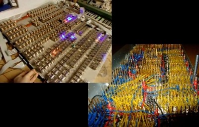

This is a bit more complicated than the science fair project I did about 50 years ago.... My project was a 32 bit, two input binary adder. I was working in a hardware store at the time and my boss had a friend in the pinball machine business who donated all the relays.
A neat feature was when you added 0001 to FFFF you could hear the carry (it was a ripple carry circuit) for a couple of seconds, then watch the transformer smoke a bit. Pretty cool for its day.
BTW, I got an honorable mention at the science fair (maybe because of the smoke...)

A 32 bit adder has a total of 95 relays. Setting up all ones in one input and then a single, least significant one in the other causes all the relays associated with the first input and all the carry relays to pull in, a totatl of 63 relay coils. This is an extreme case (all ones in both inputs is worse as it causes all the relays to operate, which also smoked the transformer, but it didn't make such a pleasing noise...). In short, the transformer was under rated. I should add that the equipment I designed for the old Bell System had power supplies with better ratings....

Because the transformer was undersized, of course.
More seriously, because all the 'carry' operations, caused all the relays to fire.
It's a reasonable guess the pinball-machine salvage was in large part 'latching' relays, which (like CMOS) draw power only when changing state. A 'carry' across all the bits meant that all the output relays, as well as those driving the 'carry' lines, changed state,
Actually there were no latching relays used, just a transformer that was more than a "wee bit" too small....
ET
PS - the real work was changing the contacts on the relays to provide the required logic. I still have some of the left over parts....
