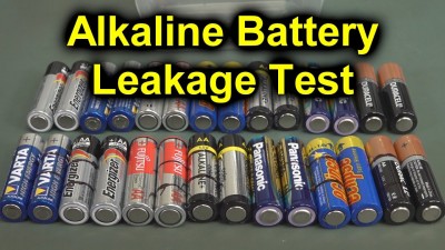

Check out this link. I think you will find it interesting....
