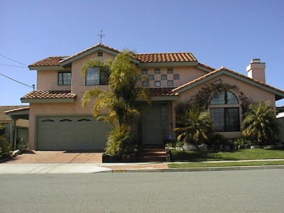

So now I am the lucky owner of two RHODUL-04VR outdoor enclosures. YAY! They are on their way via Fed Ex. I hear that the hornets are already packing up to move in. But seriously, I know that I also need a mounting bracket. Can anyone make suggestions in that arena, brackets to avoid? And also, is there anything I need to be aware of in order to not be short of all of the parts I need? Also, any sources you can recommend, or sources to avoid? I'm not sure yet how/where we're going to mount this beast, but it will probably be something akin to the RHOLW, mounting on the wall, projecting out over landscaping. Thanks!

There are many types of mounts. Like: corner mount pole mount pipe mount If you are you trying a roof mount, one needs to know what type of roof you have, or if a wall mount same thing.

As I said previously, we're thinking of the wall mount projecting over landscaping. This will be attached to either stucco, or the wood trim. Perhaps I should point you to a picture of the house.
below the weather vane is the most convenient spot to put the camera. It is currently inside the window just below it. The darned palm tree gets in the way of it right now. I suppose that will still be a problem when it's outside.
I'd put it on a standard mounting arm...on the wood not the stucco (pita). You can bring the wires right in through the gable vent.

You have a attractive house. From the elevation you posted it is hard to know if a long arm would reach over the ornamental vegetation. Perhaps going up would get you the view you want without having to cut back the verdure. Maybe start with a ROTRF to add with a RHOTR
Thank you, Roland. I appreciate the suggestions. I'll scope out the two parts you mentioned and do some measuring.

Congrat's, yes watch out for the hornets. Your new dome can be fitted with an End Cap Assembly "ROENDC" which will allow easy connection and access to splice points. You can then go to Home Depot and get 1 1/2in threated plumbing hardware to fix/bolt it to the eaves. The Pelco PP350 wall/Parapet mount mates to this product quite well. Goo luck.. seal your dome
