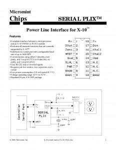

It provides an OEM X-10 interface for third party products such as...
LynX10 (discontinued) Ocelot Leopard HomeVision JDS TimeCommander many alarm panels etc.
It is identical to the TW523. The manual for the PL513/TW523 is available on the X-10 web site.
You can find several PIC based DIY projects that use it.
Micromint makes a serial PLIX chip that simplifies interfacing it with RS232.
