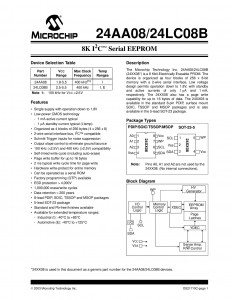

Mine all use a Microchip 24LC08B. The datasheet 24LC08B says it's good for
1,000,000 erase/write cycles. You should be able to rewite a memory location 10,000 times a day for 100 years.

Thanks Dave - much appreciated. (I have a user who is loading schedules twice a day and I wondered whether he might expect a CM11A failure after a couple of years for that reason.)
Regards, Charles Sullivan
Dave, your math is a bit off.... I calculated 27.4 times per day for 100 years. But the end result is the same... don't worry about wearing out the chip.
