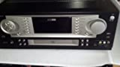

Comcast HDTV Box open original image
I am still using Comcast analog cable and I just bought an HDTV-ready large screen TV. If I were to buy a Comcast-compatible Motorola DCT5100/1000 cable box from EBay, and install it myself without having to call Comcast, will the HDTV work? In other words, is the HDTV signal already in the coax cable feeding analog signals to my home, and all I need is something to decode the signal? The reason I don't want to call Comcast is because they insist on a hefty installation fee and have a long waitlisted installation schedule. This is on top of a monthly rental for the HDTV box itself which runs till infinity. Thanks for any help.
You should be able to go to your local ComCast "store" and pick up the box for the rental fee and install it yourself. HDTV is free (AFIK) with the box rental. You will likely have to call customer service to have them activate the box and that can take 15-20 minutes.

This can be a problem. I purchased a DCP 501 for a bedroom, and it took awhile.
this unit has a non-HD DCT 2000 cable box built in.
The 800 service number was not very helpful. First, it was "You cannot use your own box", and "where did you get this from, it may be stolen". Trying to explain that it is a retail available low end HT unit was a useless exercise. They were completely lost as to what to do. "That GI number does not show up in our database"...so I explained that well, it is a database, so you could enter data, or else, how would you get new shipments of boxes in....
I finally called the local service, and they came out, called the warehouse and had them enter the GI number into the database and I finally got it up and running....

He could always purchase a QAM compatible tuner, if he so chooses. Comcast is a pain in the ass about consumer purchased digital boxes. It took about 3 weeks for them to finally get my DCP 501 into their system, only after I finally was able to convince them that it was not a pirated box, but a consumer available low end HT receiver/DCT2000/DVD combo.
