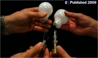

Long Live the Incandescent! open original image
Today's NYT has an article on incandescent bulbs that meet the energy efficiency mandates that were expected to make them obsolete.
And last week, when announcing tougher energy efficiency mandates for straight tube fluorescents and reflector bulbs, Obama said that 7% of US energy use goes for lighting. That's about the same percent that I had come up with using DOE statistics and a far cry from the bogus 20-25% figure used by the eco-terrorists and other Wallmart shills.
And here's another interesting read on CFLs.
Looks good, I especially like the low parts count to make them. I hope someone combines the reflective coating technique with the laser- etched filament technique to possibly obtain even greater efficiencies. I never liked throwing out a ballast and all those other parts with a CFL. I still contend that the supply chain needed to make a CFL (resistors, transistors, capacitors, coils, mercury, phosphor, gas handling, etc) outweigh a simple bulb with only 5 low- tech parts. If you add up the total cost of manufacturing and mining and delivering the resources for all those individual parts then dump them all into landfills, I think the "true cost" of CFL goes way up. But the lobbyists conveniently leave out the cost of logistics and deep supplier costs associated with all the parts needed to make a CFL.
Not being a physicist, I don't know whether the combination is possible. I does seem an obvious way to further improve it. The laser etched filament seems similar to the "tungsten lattice" developed at Sandia Labs.
