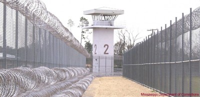

Is that what they used to isolate the Baltimore prison to prevent the inmates from using cellphones from the inside to organize crime outside?

I guess the prisoners need to build yagi antennas to get to the real network.
Jamming is easy. Spoofing requires far more hardware and expertise: Most of the cellular test equipment can do much the same thing. This one should do for emulating CDMA (not GSM) systems: Some YouTube videos of a similar test set in action:
I didn't understand the article, but they said this: "Jamming the phones is illegal and impractical, Smith said. ?I?m inside the unit, and sometimes I need to make a call.? Technology to detect them is not always effective, and once they are identified it can require a confrontation with an inmate to confiscate it."
So, it's not a jammer for sure. And, it's not a triangulator either.
It looks like they are *all* the carriers at once, and, as you said, the from Tecore Networks Intelligent Network Access Controller (iNAC) system only allows whitelisted IMSI-based calls to be passed through.
Some people are complaining though, that they drive by the prison in Baltimore, and they can't make phone calls:
Service monitors were never blocked, even in the analog days.
Another good article. These people drove by the facility and the prison system was stronger than the real cellular. Because they weren't on the white list, they couldn't use the service.
Since the carriers are all on different bands, there is nothing stopping the facility from being on all systems, well presuming you have the money.
This setup isn't really all that different from set ups at say convention centers or in the subway. The only difference is the white list feature.
