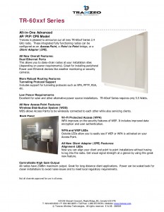

That would be a TR-6015F. What's an "agl"? Oh, Above Ground Level. That's not the way it's usually specified. Try HAAT (Height Above Average Terrain) instead. All trees are obviously identical. Is this tree directly in the line of sight? Any particular type of tree? If the tree…
