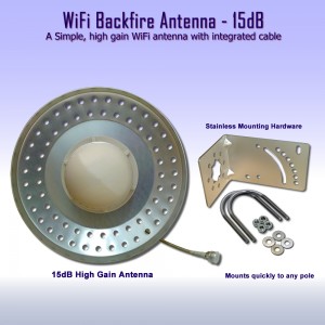

Jeff, et al: Is this antenna worth it?

I don't know. The specs are fine, but there are no pattern graphs or VSWR graphs. I don't believe the 15dBi gain for a 10" diameter antenna and suspect it's a few dB less. $60 for 15dBi is also pricy. You can get a 19dBi dish antenna for the same price. How are you doing to use…
How are you doing to use this antenna?
