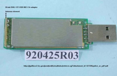

In my tin cantenna, I calculated the distance from the bottom/closed end of the can that the dongel should be placed. Used a drill and drilled the side of the can. Two holes, then bent the tin between the holes. Need a rectangular hole the size of the USB connecter in the dongle. Then I insert the dongel from the inside of the can, thru the hole, with the label edge of the dongle facing toward the open end of the can. My hole is such that only the USB adapter part extends thru the hole in the side of the can.

antenna element is near the top of the dongle, perpendicular to the body of the dongle, so it winds up being nearly centered in the can.
I had used the calculations on
to determine that the bare reflector for a cantenna of 4" should be at 1.72" from the bottom of the can. That's where Bob and I each made our holes in the can.
