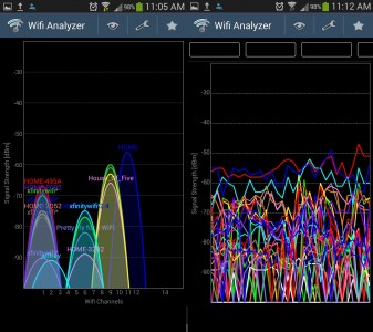

I ran a WiFi survey using "Wifi Analyzer" freeware on my Android phone in a college-dorm atmosphere earlier today (after installing Windows 10), and I think I completely understand the 2.4GHz wifi signal-strength chart; but I totally fail to gather any useful information out of the
5GHz signal-strength chart (specifically what band to set the 5GHz wifi adapter to).
The 2.4GHz chart is at the left; while the 5GHz chart is to the right. Can you help me interpret what I'm seeing in the 5GHz chart?
I can't make any sense of the 5GHz chart (for example, what band to use?). Can you?

Puzzling that your graph or chart on the right does not have a labelled "x" axis. What is it showing? If it is meant to be like the chart on the left then that suggests that you do not have anything but noise at 5 gHz. Looks like a lot of noise.

You could start by choosing the same graph format for both images and then actually choosing the 5Ghz one for the one on the right (hint no 5G displayed)
C
Char Jackson
While viewing the 2.4GHz chart, tap the screen once. You'll see a freq band indicator over on the left, near the -db scale. If you do nothing, the freq indicator times out and disappears again, but if you tap it while it's visible, the screen switches to the 5GHz band.
What you're calling the 5GHz chart is really just another view of the 2.4GHz chart. You *swiped* to get there. You need to tap.

No, it's not. We've been through this before. If your smartphone supports 5GHz wi-fi, Wi-Fi Analyzer will produce a square box, near the upper left hand corner of the screen, just below the "W" in "WiFi Analyzer" with either 2.4G or 5G inside the box. The problem is that the box disappears. Tap that area and the box will magically appear. Tap it again to toggle modes. Also, if you're looking at 5G and no SSID's are showing, the program will magically switch back to 2.4G.
The mess you were looking at on the right is the signal strength versus time graphs. Too bad the author of WiFi Analyzer didn't bother adding page titles.
You're not done yet. I've noticed that several "smart" devices, such as cheapo cell phone and tabloids, that are allegedly dual band, turn off the unused band when connected to an access point. The result is that WiFi Analyzer pretends that there's no 5G in the device. Disconnecting from your access point should solve that problem.
Also, there's something wrong with your Comcast connection. Your download speed is fine, but you should be getting about 12 Mbits/sec upstream. At least that's what I've been seeing at various customers. Winner of the highest residential speed award so far was about 160/30 in Felton with a Comcast Cisco DPC3939: There's suitable conspiracy here, but I promised not to tell.

Anyway, I can't make any sense out of the 5GHz graph, so, I was hoping someone who knew what it means would chime in.

At home, with only a handful of 5GHz WiFi signals, the chart is easy to read, and you are correct, the graphs are color coded to the access points (ESSIDs) in the boxes at the top, and the upper squiggles are of greater signal strength.

The 5GHz graph from Wifi Analyzer freeware has signal strength on the Y axis (-30dBm at the top line, then -40dBm, -50dBm, -60dBm, -70dBm,
-80dBm, and -90dBm on the first line above the x axis, where the y intercept must be at -100dBm Signal Strength.
The X axis isn't labeled, but it must just be time since I can watch the graphs grow from one side to the other in about two minutes time.

Oooooooooooooh. I *did* swipe to see what I was calling the 5GHz chart! (How did you know?)
I see now, that it's the *same* chart, only over time instead of over frequency! (slaps head ... duh) It was just frequency versus time for the x axis between the two charts. (embarrassed).
I see I have 5 options for viewing that 2.4GHz chart:
Channel graph
Time graph
Channel rating
AP list
Signal meter
If I *tap* at the top left (near the top of the y axis), then I see a box with "2G" and "5G" alternatively, as I tap that box.
Geeeeeeez. I feel stoooopid.

I only just now realized that what you are saying it totally correct! I was wrong. I misinterpreted what I was seeing. And that's why it confused me.
Now I see that, since I have far fewer access points at home.
When I tap the top left, I do get a 5G and a 2G box, alternating with each other. So, WiFi Analyzer does seem to see both.
