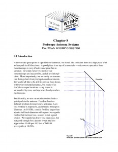

No. Search the net for calculations for "periscope antennas".
