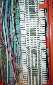

RE: How do I Punch down new phone lines  on the  66 blocks open original image
How can I complete this task? I have a 66 block with analog lines coming into the block the 66 block that connects to a phone system. I need to identify the correct phone numbers coming out of the block. Punch down the lines using cat3 or cat5 cable bypassing the phone system and running the new punched down lines straight into a FXO card in a router. so the phone line no longer go to the phone system box but a router to connect the new phones to the network for VoIP. Any help would be appreciated. Thank you
Is your question how to determine which line is which?
Google for punch block tool. There are two flavors, 66 (POTS) and 110 (network), you'll probably want a tool with both blades.

It is a telecommunication block to punch down telephone lines. I'm not sure if it is an American thing or used elsewhere. Some more info is here:
Hope this helps

Do you have Krone blocks? Turn it sideways, put legs on it, and that would be a 110-AW50 block. When you put in 4 rows, its a 100 and with
12 rows you get 300 pairs.
