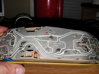

Trimline handset has to be disassembled to get at the transmitter element. Under the light plate there are two screws that hold the set together.
Here's a shot of mine with shell separated.
There are four screws you have to remove to separate the guts from the shell:
Two on the transmitter end
Two on the receiver end
Be careful removing the transmitter element. It's got a tension cup on it that had to be pried off very gently because the plastics inside the phone are pretty old.
Then just take the element out and give it a few sharp raps.
