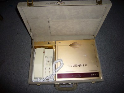

IMTS used much lower frequencies and higher power than AMPS, so it's hard to see how you could use the same cables. See
Also, IMTS phones were big, briefcase size or bigger. My first portable AMPS phone was a bag phone that would fit in a shoebox. The guts of an IMTS phone took up a significant part of the trunk, but even the first generation AMPS would fit under the seat and had all the controls in the handset.
