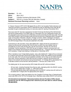

The 431 area code is _NOT_ active yet.
The Winnipeg Free Press article mentions 03-November-2012 (Saturday) as the effective date for the new area code.
If you go to the CRTC or CNA or NeuStar-NANPA website (I don't know if MTS has anything re 204/431 yet at their website), they all will say the same thing, that the 204/431 Manitoba overlay is effective on Saturday 03-November-2012.
As for 10-digit local dialing...
Saturday 20-October-2012 is when ten-digit local dialing in Manitoba becomes mandatory.
Sunday 29-July-2012 is actually the date when a REMINDER recording will be played (with call completion following the recording) on local calls still dialed as just seven-digits.
Thursday 01-December-2011 is when ten-digit dialing must be made permissive (alongside seven-digit dialing) where it isn't already possible. MOST-if-not-ALL wireless providers in North America already allow ten-digit local dialing (alongside seven-digit local dialing unless one is in an overlay area). It MIGHT be possible that MTS (incumbent landline) or some landline CLECs already allow such permissive ten-digit local dialing.
All of the dates for permissive or mandatory ten-digit dialing are when a week long "phase-in" period begins for the service providers to open permissive ten-digit local dialing, or introduce the reminder recording (with call completion) for calls still dialed as just seven-digits, or convert to mandatory ten-digit local dialing.
There will be a pair of test-numbers -- one for routing purposes, and one for billing test purposes both provided by the MTS incumbent landline side of MTS-Allstream:
431-610-TEST (8378) (NOT "supposed" to return billing supervision) 431-610-BILL (2455) (is "supposed" to return billing supervision)
At this time, Bell West CLEC, Telus CLEC, and the Allstream CLEC side of MTS-Allstream have not announced plans for any 431 test-numbers. Rogers Cable CLEC and Rogers "CallNet" CLEC don't seem to have any presence in Manitoba, thus no test-numbers have been announced for Rogers neither.
The test announcement will be English "only", although it was originally intended that the test announcement (and 10-digit reminder or mandatory recordings as well) be English-then-French, but the bi-lingual plans were dropped.
The test-announcements are scheduled to begin by Monday 30-April-2012, and be disconnected (or at least access to the MTS test-numbers by long distance carriers throughout the US and Canada) no earlier than Monday 03-December-2012. It's possible that the MTS test-numbers and even access to them via IXCs in the US and Canada could continue through early January 2013.
NeuStar-NANPA issued the Planning Letter (prepared by the CNA), #419, on Friday 06-May-2011, the pdf file can be downloaded from NANPA's website at:
