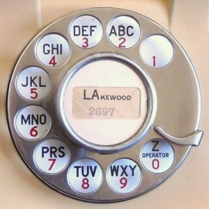

I came across this article in Wikipedia: hope it's of interest.
> During the early years of telephone service, communities that required
> more than 10,000 telephone numbers, whether dial service was available
> or not, utilized exchange names to distinguish identical numerics for
> different customers.
> When dial service was introduced (typically during the period of 1910 to
> 1970), in such multiple exchange communities, customers would normally
> dial the first two or three letters of the exchange name, followed by
> the numeric digits.
