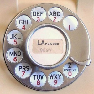

I came across this article in Wikipedia: hope it's of interest.
During the early years of telephone service, communities that required more than 10,000 telephone numbers, whether dial service was available or not, utilized exchange names to distinguish identical numerics for different customers.
When dial service was introduced (typically during the period of 1910 to
1970), in such multiple exchange communities, customers would normally dial the first two or three letters of the exchange name, followed by the numeric digits.
The "Director Telephone System" in London was not directly put in to provide 3L-4N numbers. That resulted from growth, which resulted in complicated trunking systems in a mostly all-step environment, resulting in the adoption of "Directors" (called senders in the Los Angeles area and installed for the same reason in that all-step area). The 3L-4N convention was what London adopted, and also adopted in many places in North America, but merely a typographical device, since the actual pulsing is of course numeric.
The article also says the first letter of exchange names was capitalized even where it was not dialed, suggesting that was the only case. In Dallas and Houton, and perhaps other places, the first letter (capitalized) WAS dialed.
