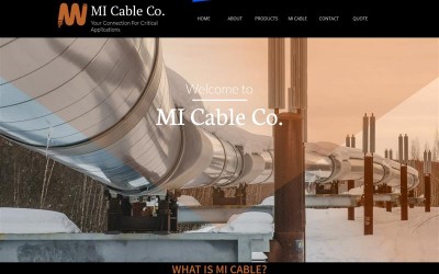

You might want to check out mineral insulated (MI or MICC) cable. It can be directly embedded near the surface of concrete and has very good current carrying capacity. I think MI cable for a 15 amp circuit is about 1/4" in diameter so a 3/8" x 3/8" cut would be sufficient. As always you need to check with the AHJ before using exotic materials.
This is a specialty item and fairly expensive.
has a price quote form and it might be worth the extra cable expense if you can make a small trench that does not tear up the floor.
