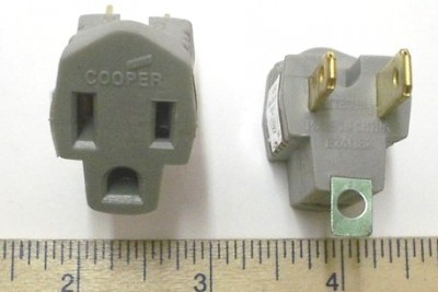

I've got a few devices that dont have an on/off switch (the George Foreman Grill, electric heater, etc)
Anyone know of a commercial a/c plug that has an on/off switch? Kind of like a power strip but compact with only 1 plug?
I see Smarthome carries a a big wireless version, but I'm looking something very small..
Something more like this:
but small like this and with a switch on it)
I can't seem to find something like this.. if it doesnt exist maybe I'll go on American Inventor!!
