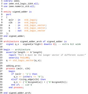

But how many "hardware" firewalls use a VHDL infrastructure? Even the big CISCO routers have their IOS. IOS is, I suspect, somewhere between an operating system and VHDL. It's text based, but it has numerous utilities. And it uses an interface for programming.
Where is VHDL processed? In firmware, or in the hardware itself? And if it has to be upgraded, how is that done? The WikipediA article just scratches the surface, and talks about theory. VHDL is in fact a fairly general-purpose programming language, provided that you have a simulator on which to run the code. It can read and write files on the host computer...
My dissertation is just the start, and plenty more details are needed.

It is a common mistake to assume, that you need an operating system for running software (i.e. filtering software to build a "firewall") on a computer.
It's not true. Operating systems have big advantages, but sometimes it's a good idea not to have one. For filtering software, in common cases there will be an operating system.
Sometimes filtering systems are implemented directly in hardware, though, i.e. through describing the tasks in VHDL, see:
