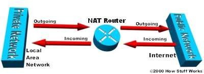

I googled about my issue and I saw lots of you who are expert in NAT. So could you please help me on this issue? :
I have one new installed Gateway1 (Yahoo BB) in my office, its global IP is, for ex: 100.100.100.100, and I can ping this IP from my PC at home. My computer at my office is connected to this Gateway1 and has IP
192.168.0.10 and it can access to the Internet.
And at my home, I also have one more Gateway2 (Yahoo BB) with global IP, for ex: 200.200.200.200, and I can ping this IP from my PC at office. My PC at my home is connected to this Gateway2 and has IP
192.168.0.20 and I can access to the Internet.
My question is: Is there any way to establish a direct connection between my PC at home and my PC at office WITHOUT any manual configuration with two Gateways (such as IP forwarding, etc.)? I mean, "programmatically".
I heard NAT can help do it, but I know nothing about NAT up to now :(
Could someone please give me an answer? Thank you very much, Truong2D,
PC1(192.168.0.10)Gateway1(Global IP1)Gateway2(Global IP2)PC1(192.168.0.20) -> direct connection possible without any manual configuration in two Gateways?

You need to setup static nat on both Gateway1 & Gateway2 such that PC1(192.168.0.10) is mapped to say (100.100.100.101) on Gateway1 and
192.168.0.20 is mapped to say (200.200.200.201) on Gateway2. I am assuming that you have more than one public IP address on each gateways; otherwise, port forwarding (or IP forwarding) is your only solution.

How ever I am a novice so I am unable to understand all. And I have one more question with SkyPE: When A and B wants to talk to each other they will establish a connection via C (C is named "Super Node") (A and B are behind a NAT device, C has a global IP). When A talks, it will send pakages to C by using TCP protocol, and then C will send ("forward"?) these packages to B by UDP protocol. What I am wondering is that: how could these UDP packages from C go through NAT device to come to B?
A=192.168.0.10, A's NAT device=global=100.100.100.100 B=192.168.0.20, B's NAT device=global=200.200.200.200 C=global=300.300.300.300
Many more thanks, Truong2D,
In article , wrote: :And I have one more question with SkyPE: :When A and B wants to talk to each other they will establish a :connection via C (C is named "Super Node") (A and B are behind a NAT :device, C has a global IP). :When A talks, it will send pakages to C by using TCP protocol, and then :C will send ("forward"?) these packages to B by UDP protocol. What I am :wondering is that: how could these UDP packages from C go through NAT :device to come to B?
B has formed an outgoing UDP connection to C, so the UDP packets from C to B are considered "reply" packets and so allowed through the firewall.
