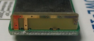

Linksys WUSB54 and WUSB11:
DLlink 122:
don't have a photo, but I unsoldered the PIFA antenna, attached an SMA connector in its place, and connected it to an external patch antenna. It's current running on a neighbors rooftop.
USB adapters with chip antenna open original image
I have been using some small reasonably cheap USB 802.11b/g adaptors obtained from a local electronics store under their own branding (Dick Smith Electronics for Aus and NZ) but these are now non-stock.
We remove the flip up chip antenna and wire directly to a biquad with minimal lead length. Performance on the end of a USB cable is excellent.
Are there any suggested or recommended small USB units with similar antenna that can be readily removed and the unit fitted to the rear of the biquad as in the past? They need to have driver availability for Win98 thru to Win XP.
