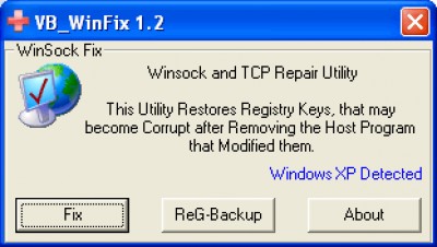

Argh. That removes all 3rd party LSP (Layered Service Provider) chains and resets everything to the original MS defaults. Most of the spyware removal tools and some browser plugs will need to be reinstalled after that. There are also complications per MS.
big a hammer, methinks.
Instead, download and run one of these:
removes an gaps and corrupted entries, doesn't totally hose the LSP chains, and leaves the plugins intact.
You may wanna also look arount the LSP chain list before attacking:

See
download update If it still fails download WinsockXPFix.exe
