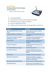

Googling the term below, the bridge appears to be "Senao Networks, Inc." NL-2611CB3 PLUS (DELUXE) LONG RANGE WIRELESS MULTI-CLIENT BRIDGE
Here is a PDF about the bridge:
And here is, I think, the right datasheet:
Up to 23dBm(200mW) RF Output Power
- 11Mbps IEEE 802.11b Compliant
- Power-over-Ethernet
- 64 /128-bit WEP data encryption
- Hide SSID (AP Mode)
- DHCP Client
- Web-based configuration
I don't recognize the device, but it doesn't seem mechanically broken other than a cracked case. Any internal or board damage? Is there a maker, model number, or first 6 digits of the MAC address to identify it?
Engenius/Senao ML-2611CB3 Plus. I'm neutral on the quality. Some say it's great, other say it's crap. No clue who's right.
