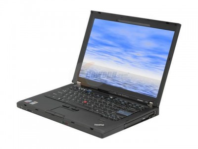

Just bought a Lenovo R61i laptop. see link
How can I add and external wifi antenna to this laptop? Want to get the antenna up much higher than what the built in antennas will be
