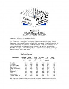

Offset feed dishes have different f/D ratios depending on polarization. I just did a quicky measurement of an RCA (Thomson) dish which yields 0.67. Close enough. Exactly. See: how it works. Be sure to read chaper 6 on feeds. Biquad should work. beamwidth of the biquad is about…
DirectTV 20" dish, offset fed, f/d~0.7, to be used for 2.4 GHz wlan link.
Exactly. See:
Biquad should work.
beamwidth of the biquad is about 60 degrees. Using a protractor to eyeball my pizza dish, it wants a 70 degree angle. Close enough.
