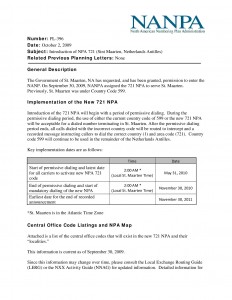

NANPA's latest planning letter
the assignment of NPA 721 to Sint Maarten, Netherlands Antilles. Permissive dialing begins next May 31, after which time numbers in SM can be dialed either as +599 54N-XXXX or as +1 721 54N-XXXX until November 30,
2010. At that point, +1 721 dialing becomes mandatory.
