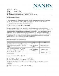

"St. Maarten Update - NANPA received notice that St. Maarten achieved autonomous country status effective October 10, 2010. As such, they are moving forward with the implementation of the 721 NPA code. Specifically, the plan is to implement permissive dialing of the
721 NPA on September 30, 2011, with mandatory dialing on March 31,
2012. NANPA will publish a Planning Letter with further details in January 2011." Today, Wednesday 05-January-2010, NeuStar-NANPA issued a new Planning Letter regarding +1-721 Sint Maarten, PL #418, which can be downloaded from NANPA's website at:
The new/revised implementation dates are mentioned, and are the same ones as mentioned in the NANPA/NANC document from the December 2010 NANC meeting. The PL also mentions that 31-March-2013, a year AFTER mandatory dialing, is the date when carriers can begin removing any mandatory dialing recorded announcements for calls still dialed as +599 for legacy 5xx-xxxx Sint Maarten numbers.
There are still errors and omissions in the current/revised PL-418. It still mentions that "local international calls" to French Saint- Martin are dialable as "seven-digits". That can't be true, since there are no "local" calls between the French and Dutch sides, although the rates/charges are not really expensive for such a distance. Calls must be dialed as 00+, with apparently (hopefully) NANP dialing procedures (011+) introduced for calling to the French Saint-Marin side with the official integration of Dutch Sint Maarten in late 2011/early 2012.
MAYBE... this reference to "local international calls" to the French side refers to French-side businesses which have requested and been assigned FX lines with Dutch-side-based +599-5xx-xxxx (to become
+1-721-5xx-xxxx) numbers, which would be dialed locally from the Dutch side as 5xx-xxxx?
Also, while MOST of the wireless providers' c.o.codes are now listed in this new Planning Letter, there are still a few missing.
The incumbent landline provider is "Telem", and most of their office codes (54x range) are listed. There MIGHT be an additional code for Telem, in the 52x range which is NOT shown.
If Dutch Sint Maarten does indeed have landline CLEC providers, which I think they do, their office codes are NOT shown in the new NANPA PL.
TelCell is the largest wireless provider, and is associated with the landline incumbent telco Telem. There is currently a +599-555 code for TelCell! If that isn't changed to something else when +599-5xx Sint Maarten migrates to +1-721-(5xx), then there is going to be a conflict with US/Canadian service providers who treat all NPA+555 as Directory Assistance/Information! Calls intended for TelCell phones on 555-xxxx might either be blocked, or be routed to Telem incumbent Directory, or might be routed to "AT&T, What Island Please?" Caribbean directory "intercept". Even though all of the NANP-Caribbean has been broken into their own distinct NPA codes during the 1995-99 time-frame (and some have since been overlaid as well), AT&T (and other carriers) have been known to STILL route Caribbean NPA+555-1212 (except for calls to the two US Caribbean locations -- 787/939 Puerto Rico and 340 for the US Virgin Islands) to an AT&T OSPS operator who's pre-recorded auto-voice answers: "AT&T, What Island, Please?". This is supposed to be a fraud preventative measure. The AT&T operator will connect the call to that Caribbean inward directory operator and MONITOR the connection just in case the Caribbean inward directory asks the US/Canadian calling customer if they would like to be connected to that desired number. And thus a "directory call" at a fixed rate might be used for a longer conversation to a (non-US) NANP-Caribbean point! The AT&T operator would disconnect the call to the directory operator and instruct the caller to re-dial to the desired number.
There's no mention in the current NANPA PL for Sint Maarten specifically on whether or not 011+/01+ will be used for Sint Maarten to non-NANP points after they officially become part of the NANP. Currently, 00+ is used to place calls to points outside of +599.
There's no mention on whether or not N11 codes for services or '0' for the local (Telem) operator will be used. Presently, Sint Maarten and other +599 islands (former Netherlands Antilles) use their own locally assigned three-digit 91X and four-digit 92XX codes for special services and the operator. And these are NOT referenced at all in the NANPA PL. Many NANP-Caribbean as well as non-NANP countries have been known to use 91X service codes. And since it in the 91X range, 911 is used for Fire/Police Emergencies (but 912 is for Ambulance services) in Dutch Sint Maarten.
There are probably more things that SHOULD be addressed in the NANPA Planning Letter, but aren't right now. Hopefully, these will be in a future PL, especially the test-number, and correcting any errors and other omissions. (There's nothing mentioned about "equal access" for toll calls, whether currently or in their NANP migration, nor what codes are dialed for "vertical services". Are they going to use
101-XXXX codes? 11(X)XX / *(X)XX codes when they join the NANP?)
