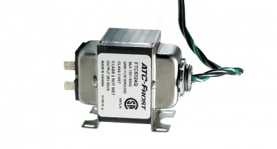

Here's a funny one. Town of Huntington, NY can waive the installation of 120V interconnected smoke detectors if a listed control panel with fire capability is installed in a residential occupancy. The kick is the building inspector says that Residential Code of NY requires tha system be powered by a non- unpluggable Transformer or 120V! Any one see that in NFPA 72 or 70? There was some discussion about a guard around a transformer- to prevent unwarranted removal. My take is #1 its FPL wiring #2 FPL listed transformer or Class 3 is acceptable ( he wants a permanently wired transformer- like a bell tranny!) My reply was most Manufacturers submit the transformer(plug-in)AND Control Panel for listing by UL- I violate that by substituting a tranny of non-listed origin and open up a liability issue! Comments and Replys appreciated! Mike Sokoly MES Security Systems snipped-for-privacy@optonline.net

You may wish to consider a unit such as this:
You can order them in a variety of sizes and the secondary output can also be ordered in a configuration to allow mounting to a convenient knock-out on the control panel. The primary end is usually terminated in your standard
1110 box. This eliminates exposure of the secondary output and the inherent risks associated with that. This device is "UL" and "CSA" Listed.
Regards,
Frank

Interesting argument about the listing issue, Mike. If he insists, the solution is to use a boxed, open field transformer with 110VAC leads. Have a look at Altronix' AC power supplies. If the inspector refuses to accept the listed transformer for the job, ask him to state it in writing on town stationery. Get him to sign off on the submittals with the replacement unit included and you're butt is covered, albeit at an unnecessary cost increment.
