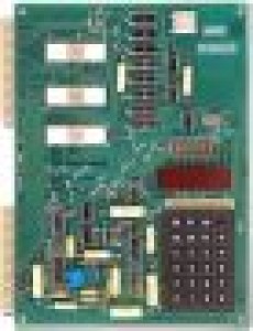

[Q] Can I use 230V/50Hz X10 Modules to 220V/60Hz country? open original image
I'm in South Korea. In my country, the power line is 220V/60Hz.
So, I want to use X10 Europe modules (230V/50Hz). I know X10 voltage tolerance is +- 10%. so, the voltage is not problem. My question is the frequency.
Is "50Hz vs 60Hz" matter? Can I use X10 Europe(230V/50Hz) module in my country?
Please let me know. thanks.
