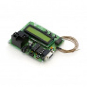

There are a few kits available designed for controlling toaster ovens, turning them into programmable reflow ovens for soldering of surface mount components. They use triacs to control a resistive heating element. I would think they could be modified for this task as the wattage is about the same although the tempertures are much higher in the small, convection ovens. The price is within your budget.
If you post to their forums asking for help controlling the temperature in a cathouse I'm sure Nathan will offer suggestions.
Here's another but it's more money and less amenable to modification.
