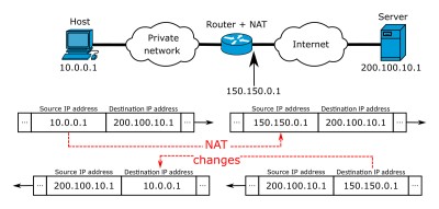

If 192.168.2.1 is your gateway and 192.168.2.2 is your computer, then this is communication from internet to you. Are UDP ports 350** forwarded, if so do you really need it, if no close them. If you use Windows ME or XP and if your router supports UPnP services, are they enabled, if so router may automatically forward ports.
About MAC:
