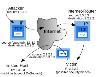

First, it's not my network. Second, you man want to read [1] to understand that a source IP from a private network doesn't necessarily mean that the packet came from the LAN. Third, we don't know anything about the OP's LAN, so we can't possibly know whether there is a box with IP 19.96.1.2 on his LAN. So the attack may or may not come from his LAN. It may even be the AV software misinterpreting packets.
[1]
