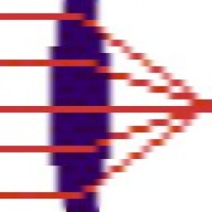

Picture of Lines in Fiberscope images
Nov 19, 2007 23 Replies
Jump to replies (23)
Picture of Lines in Fiberscope images open original image
The above are actual images of the lines in the fiberscope images I took up with a camera. I merely added the white arrow to point to the alternating lines which appear in all images. In the picture, it is sky above the city.
So how do you think the lines were caused by? bent, broken fiber bundles or tube inside the lens? Any ideas or theories? Thanks.
