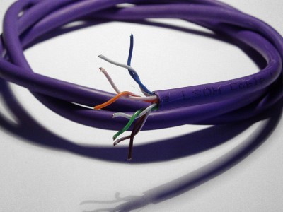

I am teaching Networks at a college, and I wanted to know, what are the most common twisted pair categories. I know about category 5, but there are several listed in the book. including:
Cat5 Cat5e Cat6
What are people most commonly getting now in new installations?
thanks.

The choice is between Cat5e and Cat6. Occasionally people find and run lower for residential POTS.

New installs should be cat 6
D
Denis Jedig
Not necessarily. Cat6 is more difficult to get right than Cat5, it is more expensive to certify and Cat6 cable[1] is considerably more stiff and has a greater diameter than its Cat5 equivalent.
So there still are arguments for a Cat5 installation, the main one being that just using Cat6 cable and Cat6 termination equipment will get you nothing more but an expensive Cat5 link most of the time, except when you are adequately trained, have the equipment to certify the link and have enough knowledge how to fix common problems.
[1] especially the AWG23 S/STP variants thereof - at least in Europe we do not use UTP for Cat6 installations

The short answer to your question is: CAT5E is most common Longer version: CAT5E is most common because it is (relatively) cheap and supports 95% of the application that can be found at work desk location - up to Gigabit Ethernet.
