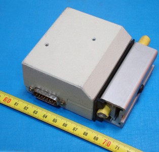

I think I still have my 10base5 tap installer tool.
First there is a part that clamps onto the cable with a threaded hole. After clamping it on, one end of the tool drills a hole (by hand, it doesn't take long) through the shield, and almost through to the center conductor. Next, a part with a sharp point is threaded into the hole and tightened by hand. The sharp point goes into the center conductor. Also, the clamp part has two electrodes that cut through the outer layer and contact the shield (outer conductor) of the coax. Using two contacts to the shield allows more accurate sensing of collisions while transmitting.

Can you please clarify this ? I never had the 'pleasure' of actually installing a vampire tap. But I am told that the cable was layed out in such a way, that on certain spots there was some kind of opening in the shielding. Spots that were marked on the outsite as 'vampire here'.
So, just to be sure: do you actually remove some of the shielding with some kind of drill or do you punch the tap at a spot where there is a pre-made void in the shielding?

Gerard Bok wrote: (snip)
There are marks on the cable, but they are unrelated to any openings in the shield. If too many taps were placed too close together, the effects of the capacitance of the transceiver input could cause problems with the signal.
To avoid that, the cable is marked every 2.5m where one is allowed to place a tap.
The tool is shown in the picture on the web site.
It has what looks like an ordinary drill bit embedded in the plastic. It is just long enough such that the hole goes almost through to the center conductor. It is sharp enough, and the shield is soft enough, that it cuts and pulls the metal out of the hole. Stray pieces of shield could short the cable, but that never happened to me.

Slightly different - install the clamp, which has teeth to pierce the jacket, and make reliable contact with the outer shield. One next threads a cutting tool into the hole in the clamp. This tool cuts the circumference of the hole, like the spur of an auger bit wood drill (the old fashioned kind used with a 'hand brace' type of drill), as well as drilling a tiny hole PART WAY through the inner insulation. Remove any debris (strands of the outer shield, and anything of the inner shield), inspect the hole, and thread the transceiver into that hole. This act pokes the hole the rest of the way through the inner insulation to make contact with the center conductor.
